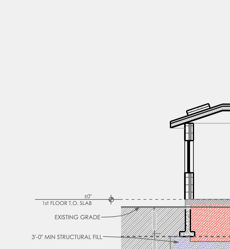

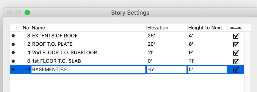

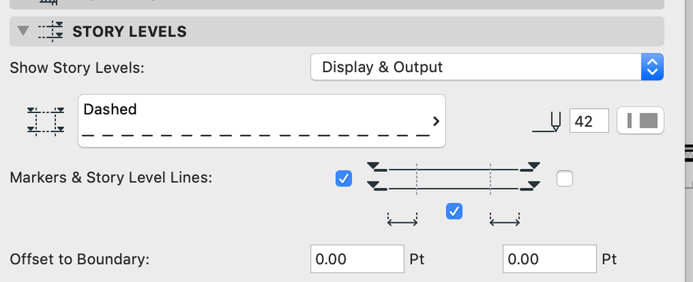

Hey there,
I have multiple story levels in my project but only one is showing up in my section. I have all stories selected in my story settings and show story's on display and output. What am I missing? See attached images...
Screen Shot 2022-12-01 at 6.43.45 PM.pngScreen Shot 2022-12-01 at 6.44.03 PM.pngScreen Shot 2022-12-01 at 6.44.47 PM.png

Check the vertical range limit in your sections. If a story level is outside that range it will not appear on screen or print even with the settings you have above.
