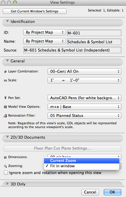

I have used the Rotate Orientation function to rotate a floor plan 90 degrees.
I then dimensioned the drawing.
However when I bring the drawing into a layout, the orientation of the vertical dimensions rotates 180 degrees.
I have been able to correct text that gave me the same issue but not the dimension text.
Hope someone can help.
Thanks
Tim
1 Reply 1
Eduardo Rolon
You have to update the Zoom Settings on the saved View (select Use Current) after Rotating the View and this will save your drawing rotation and the Dims.
