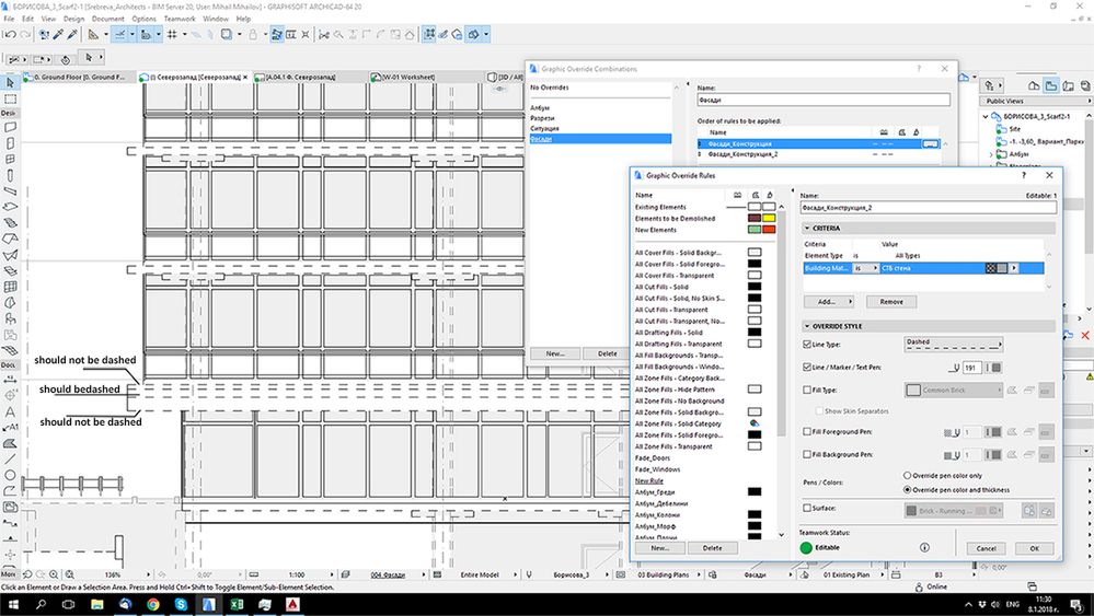

I am trying to make a graphic override which makes all elements who are structural appear in dashed lines. The building code of my country requires that the structural elements of a building be shown in dashed line on the Elevations.
I tried to make the override using the building material and overriding its lines. This works, but when I have a composite it overrides it all even though it has various building materials in it.
Does anyone know how I can work this out?

As I have posted once in the german forum it is somehow a bit possible:
(together with a different pen set you can achieve even more as its easy to imagine)
1) No override.
2) Fills set to "only foreground"
3) Fills set to "only background, override with blue pen"
The insulation has its background set to zero.
Anything with background pen of zero won't be overriden. This is by design.
