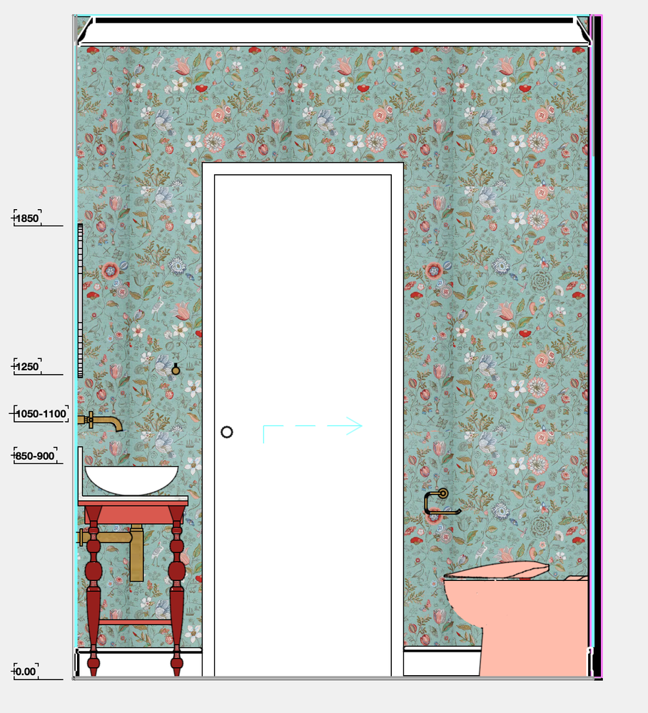

With the release of AC25 we took advantage of the ability to output textures & materials in elevation etc (Image attached 'Forum_01'). We've been experiencing a problem on some jobs where the exported PDF set (Image attached 'Forum_02' and 'Forum_03') takes so long to print it stalls the system and needs to be cancelled, or the printer simply moves on to other jobs.

David - attached are two PDFs that have been the primary source of the problems, meaning whenever the printer gets to these pages it stops. One is a plan view with a floor tile, the other is a number of elevations with a wallpaper. Both of these surface materials are smaller PNG files, and we ask Archicad to 'tile' over a surface.
By reducing the size of the 'source image' I was able to print the floor tile PDF without problem, but the wallpaper remains a problem - no matter how far I reduce the image size or bit depth of the source image. I have also tried reducing the number of elevations on a single A3 page, but this doesn't offer any improvement either.
