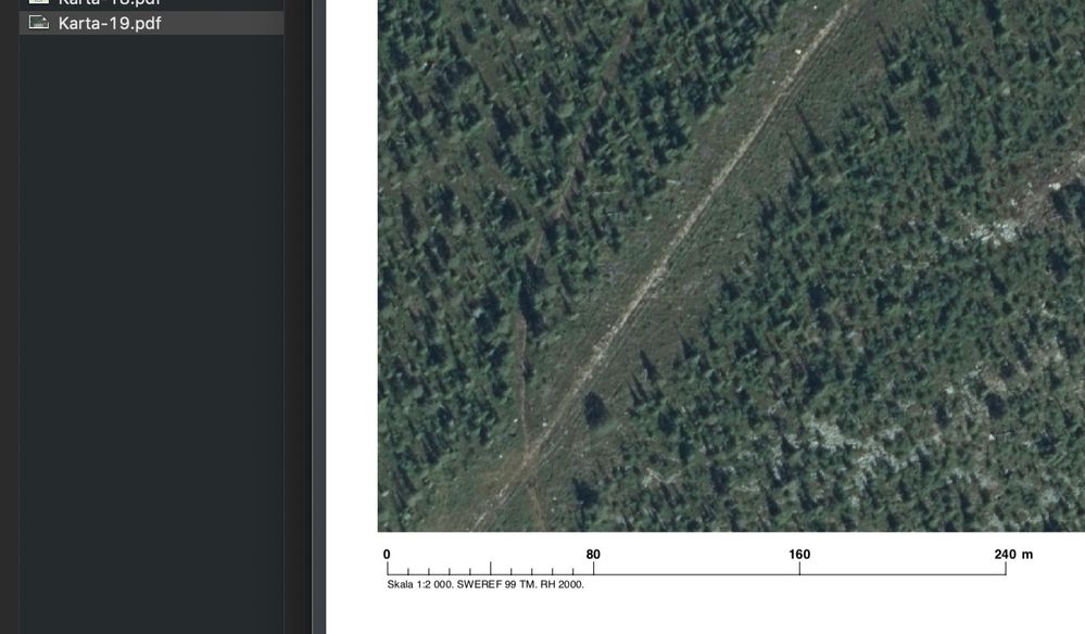

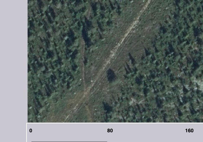

I have a strange bug. When I move PDF to Archicad it lost a scale and I have no clue why, also when I explode the pdf scale also missing.
Export to Archicad
Exploded

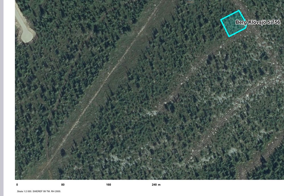

Hello,
That's an interesting finding!
Since the structure of the PDF file is modified via Adobe Reader, there is a chance that the PDF is "fixed" upon saving, thus importing the PDF into Archicad is correct again.
Thank you once again for your finding! I will keep that in mind next time it happens!
