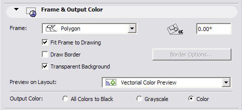

the drawing or view or pmk is set to have a transparent background by default. The frame of this view can also be an oval or a polygon that you define manually.
Does this help or am I missing something. See image attached.

Thanks Aaron, I missed the polygon. It will sure help!
But of course a way of getting the Master items (with white background) on top of the imported drawings by default would be less work.

sorry Thomas,
isn't that what setting a "transparent background" (see the check box in the image?) for the drawings that sit on the sheets would do?

Nope. If the figures in the drawing are black, and obscure the Master's drawing label, transparent background doesn't help. I'll always want the label on top, I'm afraid.
