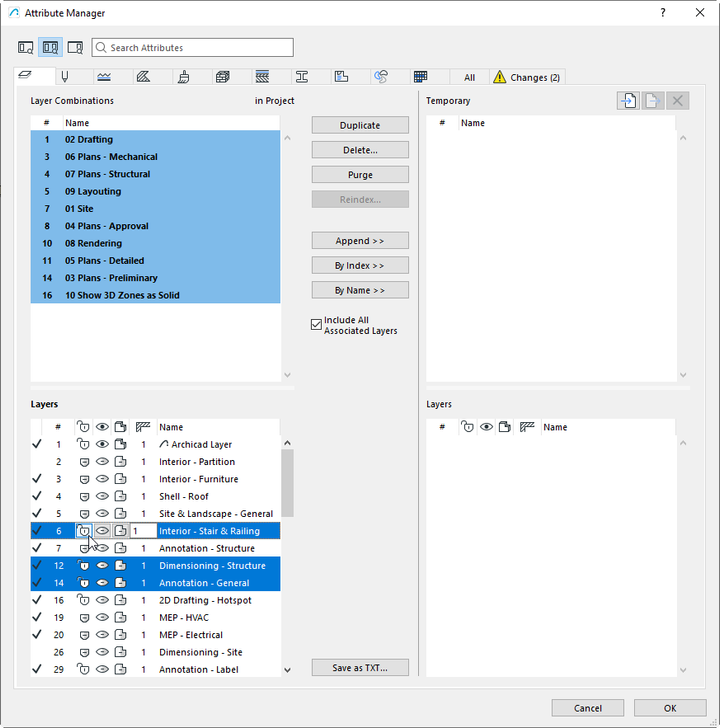

If you want to unlock those Layers in all Layer Combinations, the Attribute Manager Dialog is the place to do it in a single step.
In the Dialog, go to the Layers page, select all Layer Combinations at the top, then use CTRL+click to select all Layers you want to unlock, then click the Lock button for any of them. All selected Layers will be unlocked in all selected Layer Combinations. Click OK to accept changes and leave the Dialog.
This way, no matter which Layer Combination is used by the Views you activate during your work, the Layers will be unlocked.

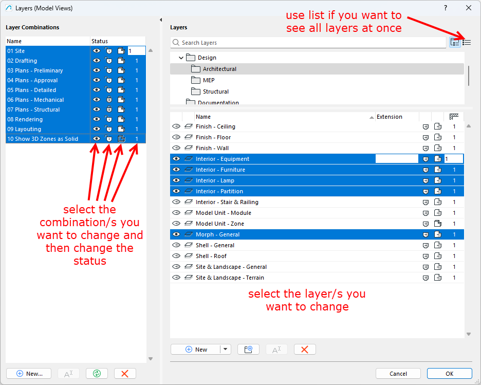

You can do it in the layer dialogue as well.
Select the layer or layers on the right and any or all layer combinations on the left.
Then change the visibility button for one of the selected combinations and all selected combinations will change.
