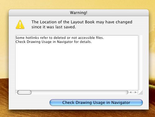

Plotmaker crashes each and everytime I try to open a Layout Book (the one I NEED to print NOW). I get the attached message right before the eventual Bug Report. Same story with the backup copy. Worked fine yesterday and I've not chaged the location of the .PLN (which I am able to open)
Putting the STRESS in Stress Co.
Any Ideas?

Can you open the default file? or other files? can you open file on another computer? or user account? are you working across a network?
You may have a corrupt font. or you may have to move your preferences out of your user library (that way you can put your worksapce backin later)

John, thanks for your response
Yes, no problem
Aussie wrote:
or other files?
Yes, I can open other layout books
I only have the one
Aussie wrote:
or user account?
It's just me.
No.
How do I trouble shoot to check?

Make yourself a new user in accounts in system prefs. Try opening the file while logged into it. If it still doesnt work that will tell you that there is most likely a problem with the file rather than andything in the system (ie fonts). Before you do that move the graphisoft prefs file out off user> library>preferences and see if that fixes it.

Also try a new plotmaker file and import the old into the new. You might get lucky with that
Gd'day John:
I did just that and was able to read and print the book (well, almost all of it). I narrowed the problem down to one page in the layout book. It was one that I "broke the Link" to (not to be confused with ArchiLink, but he's probally broke in Tahiti ) Loading that single sheet causes PM to crash. Not sure why. I get the same error message.
