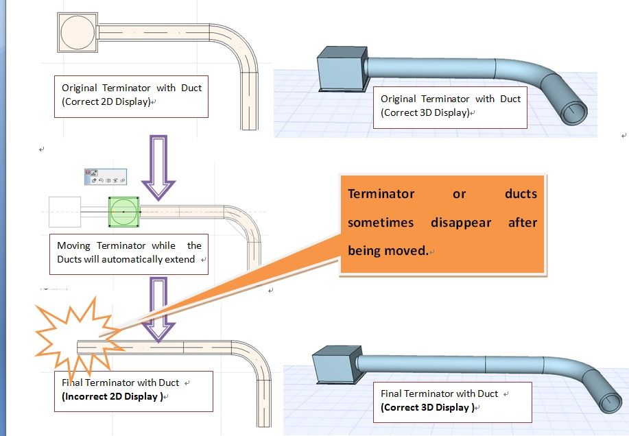

Problem of 2D Display by using MEP Add-on
1. Make simple MEP elements consisting of terminator and ducts.
2. Moving terminator while the duct will automatically extend
3. Incorrect final 2D display of the MEP elements. However 3D display is fine as well as the drawings in the layout books.
Please find the self-explained photo. Are there any solution? Is it a bug?

Looks like a bug, Kent. Can you upload a PLA somewhere with just the terminator/ductwork shown in your example so that someone can take a look?
(Nicely annotated screenshots!)

What happens if you move the terminator and the adjoining duct together to the right location, and then lengthen the duct from the far end so it lines up with the elbow?

Another interesting thing is to save the modified MEP project ,and reopen again. The 2D display of MEP objects is fine again.
I doubt the incorrect 2D MEP display comes from incorrect support of the display card for the Archicad 16.

I was able to reproduce your bug with your file. I also crashed the file once (sent Bug Report to Graphisoft). After moving the terminator and seeing it disappear from the 2D Window, I selected the Duct Terminator Tool in the Toolbox and Selected All, the terminator, while invisible, shows up as a selection (the same can be done by using the Edit Select Set command to see the terminator is there). Changing the Floor Plan and Section > Floor Plan Display > Show on Stories setting will get the terminator's 2D display back, but moving it again will repeat the bug. I post this more to help Graphisoft pin point the bug than as a solution to your issue.
