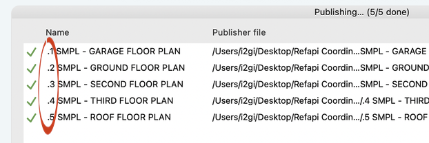

Hello everyone,
I'm experiencing a strange Publisher issue in Archicad 29 INT (macOS) that only affects one specific PLN file.
When publishing a Layout Book:
  • Publisher completes successfully.
  • Every layout shows Status: Saved.
  • The destination folder is created.
  • The Xrefed ARCHICAD Views folder is created.
  • PNG reference images are exported.
  • However, no DWG or PDF files are actually created.
I've already tried the following:
  • Created a new Publisher Set.
  • Published only one layout.
  • Changed the output folder.
  • Used the standard Graphisoft DWG translator.
  • Opened the project with Repair.
  • Saved as PLA and reopened.
  • Verified macOS permissions.
  • Searched the entire computer for the exported files.
The important part is that:
  • File → Save As → DWG from the same layout works perfectly.
  • The same Publisher settings and translator work correctly in another project.
This makes me believe the problem is specific to this PLN file.
Has anyone experienced this before or knows how to repair the Publisher or project database without rebuilding the project?
Any suggestions would be greatly appreciated.

Can you alter the names of what you are saving?
I see there is a dot (.) before each name.
I find it is good practice not to use dots in file names as that is the file extension delimiter.

Solved! 🎉
First of all, thank you to Barry, Karl, RyeJuan, and everyone who helped me troubleshoot this issue. I really appreciate all of your suggestions.
After hours of testing, the solution turned out to be surprisingly simple.
The problem was that my Publisher Subset did not have a Custom ID assigned (first image).
All I did was add "CRD" as the Custom ID (second image), and everything immediately started working. Publisher now exports both PDF and DWG files correctly.
What made this so confusing was that Publisher always reported "Saved", created the folders and Xref images, but never generated the final PDF or DWG files.
I honestly thought my project had become corrupted and was already planning to rebuild it. What a relief!
Hopefully this helps someone else in the future.
Thank you all again! 🍻
Karl Ottenstein
Moderator Emeritus
…and more than that… macOS is a Unix based operating system and file names beginning with a period are invisible in Finder.
That would explain why they say they are saved but iggiv can't see them.
