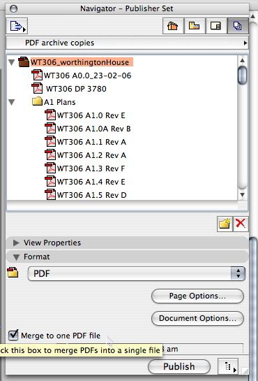

Thanks Ben & Link. I missed that little checkbox. I didn't have any folders/subsets as I was trying to make it as simple as possible for the principle architects.
Unfortunately it only gets me part of the way there. What we really need is the ability to print directly as a single job, but I can probably get something to work with this. It may not matter in the end since the printer is not producing acceptable results and we may end up with something else.

Are you not using Publisher? You need to either add a folder to the publisher set (maybe the whole book or a subset) or create one and put all your layouts in it. Then you can select it and use the 'Merge to one PDF file' button under the format tab, as per Ben's attached image.

Hello Link,
I don't seem to have that check box.
My Publishing pane has three icons that I don't recognise.
Please see attached image.
