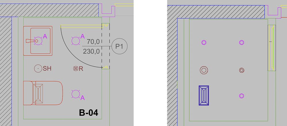

I´m using 3d documents to create Reflected Ceiling Plans but illumination or smoke detectors (eventhough set us Reflected Ceiling in symbol) won´t show each lamp as set.
It shows de circle...but not the info.
I attach a side by side comparison between my floor plan and y reflected ceiling.
Any ideas?
1 Reply 1
The floor plan is showing the 2D SYMBOL, but the reflected ceiling plan is showing the 3D OBJECT. This is similar to any 3D view. If you want to show the info also, then the 3D document will not work without adding a label.
