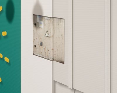

I have some decals that has been applied in Twinmotion.
The model has changed and I now want to remove some decals and relocate others, but I cant seem to select the decals in Twinmotion.
How do I select/delete them?

 On the righthand side of the workspace in Twinmotion, there is a list of components added to a project.   By default, the components are listed in chronological order as added to the project.  There are also filter switches at the top of the panel to reduce the search effort.  Once the decals are identified they can be turned off or deleted.

Thanks. I used the righthand side workspace as you suggested and now renamed the relevant components for future.
