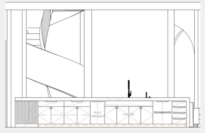

I am attaching print screen of  the interior elevations only because if I choose infinite, now it doesn't show important items on the island, such as faucet..... (it removes the backrhoudn which I am grateful for ... But I need the faucets. Just don't understand why it would not let me choose the boundary. I am using archicad 27

@cocoloco wrote:
The limited distance to hide elements in the background worked (Although per the Link,  it did not offer me to choose "add bounded area" as it was greyed out and not option I could choose, but it did helped without it too.)
I think that is something that can only be set when you are placing a new elevation.

Because you have a limited distance set, make sure that the external bounding perimeter of the elevation extends at least to the back of your cabinets, so the faucet is within that range.
