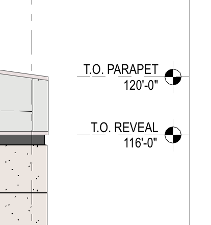

Here's the problem I'm having, my dimensions are on the "New" Status and they show up fine in the view, but once I place the view on a layout the dimension lines show up dashed and gray, which is my override setting for "Existing" status.
This only occurs on the Elevation dimensions in section or elevation. (see attached)
I think this might be a bug of some sort. Has anyone else had this problem?

And if you OPEN SOURCE VIEW of this drawing from your Layout, do you see it correctly?
If not, your RENOVATION FILTER as set in your VIEW OPTIONS is different than you want...Make sure this is set correctly...
If yes, then most like some kind of bug.
Just a guess....

Yes its shown correctly in the source view
