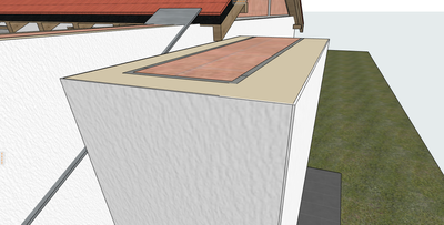

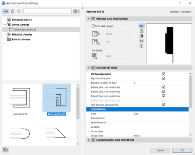

As said in the title, while using the wall end tool, it creates an unwanted line between the outer skins where there should be none.
*Note: Line between identical fills is not the problem.

If you turn off the line between identical fills does it go away?
Archicad 26, build 3001
Montenegro
Kinzy
It doesn't.

The line appears because the material off the 2 faces aren't the same and or the 2 surfaces aren't the same. If it's possible for you to set the inside and the outside skins of the composite wall with the same material, then the line will be removed. Otherwise you can place a column with a complexe profile to replace the wall end.
