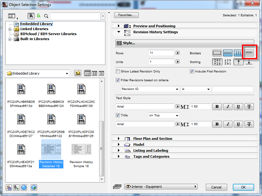

Check this post about an updated Revision History object that is available:
http://archicad-talk.graphisoft.com/viewtopic.php?t=47172
I think you will need the Detailed version.
With this new object you will probably be able to filter out all revisions except the current one (so they will not appear in the Revision History object).
The only thing you will not be able to achieve is for the Revision History object to automatically adjust its number of rows. That is currently not possible to do with this object.

Apparently this is also possible to do with the new Revision History objects that are available from the bimcomponents site, as I was again informed by the Graphisoft Product Designer responsible for the revision feature.
The attached image shows which button controls it. If the button is turned OFF, only rows that have data in it will be shown in the object.
