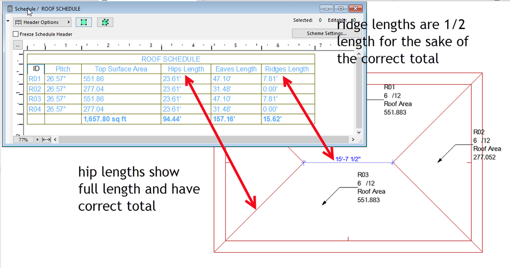

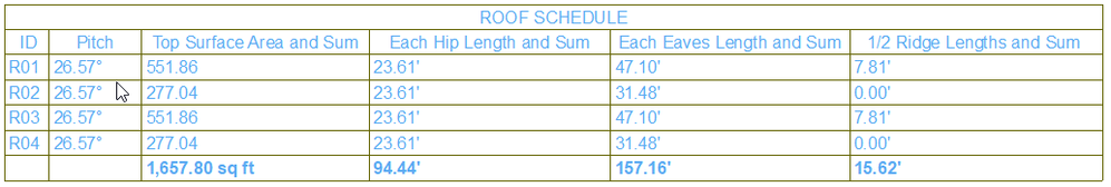

Barry wrote:The roof is a rectangular hip roof. The roof has (4) hips and (1) ridge. The schedule shows the true length of all (4) hips correctly, and the correct total length of hip.
Steve,
I think you will find your hip lengths are halved as well just like the ridge.
It is just that you have 2 hips on each roof plane so it looks as if it is showing the full length of one hip.
2017-07-27 09:12 AM
Steve wrote:Not really.
2017-07-27 05:26 PM
Barry wrote:I think our posts past at the same time. Think of what the user of the schedule expects the lengths shown to mean. If it is not explained somehow in the schedule, how would they know ? The words of the schedule need to be carefully chosen in order not to be misleading.Steve wrote:Not really.
Just as with the ridge you are only getting half the length of each hip.
There just so happens to be 2 hips on each roof plane so appears you are getting the length of one hip.
