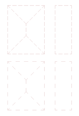

Don't know if this has been brought up before but why,why,why does 2 roof planes with the same pitch and outline line type are totally different? Can't be because ones a single roof plane? Same in AC 24

Are you talking about the look of the outline line type? That seems to have something to do with whether or not the pitching line is above or below the lowest point of the roof...
In AC22. Multipitch on the left, single on the right. 550 eave on the bottom, 0 on the top.

Brett Brown
Yes I am talking about the line type, both are the same, both have pitching line above lowest point of roof, you can see the dashes are total different sizes and spacings using exactly the same line type
Imac, Big Sur AC 20 NZ, AC 25 Solo UKI,
Are both the uncut and overhead line types the same for both roofs?
Are both on the same home story?
Brett Brown
Yes, both uncut and overhead line types are the same for both Roofs ( but are different for outline only and Overhead) and are both on the same home story.
Further investigation, both were and are set to outlines only, same line type. Both have the same  Overhead All line type which is different. The error? is the hip roof outline is using the overhead line type (which is not even an option) when you use outlines only. Another Bug?
The single roof plane uses the outline only line type even tho its overhead line type is different and the same setting as the hip roof.
So why is the hip roof not using the outline only line type?

In my images, if I move the reference line the a Zero eave, the outline spacing changes.
Brett Brown
Both are on the same story, definitely a bug in the multi-plane roof settings. You have to have the line type the same in both outline only and over head, for it to get the outlines only to work.
