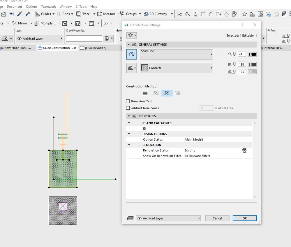

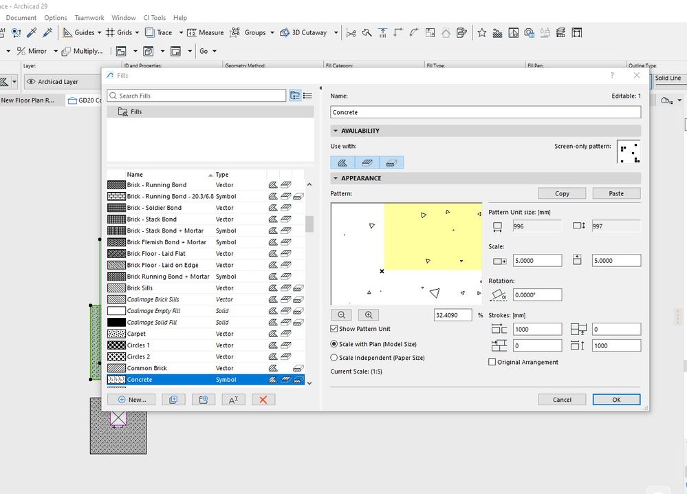

Is anybody having troubles with fills in ArchiCAD 29? I am unable to edit scales, or construction methods?

Can you provide a bit more detail? Which fill? Exactly how are you trying to edit scales? One or two screenshots would also be helpful.

I use the Construction method in the fill settings, or change the pattern unit size in the Element Attribute settings - nether make any difference? I have only had this problem since upgrading to 29

That looks like bitmap display.
Have you tried turning "Vectorial Hatching" on?
View->On-Screen View Options -> Vectorial Hatching
sometime version changes turn off things like this that you will never think about again.
I hope this helps.

Tarryn
Great that worked - Thankyou!
