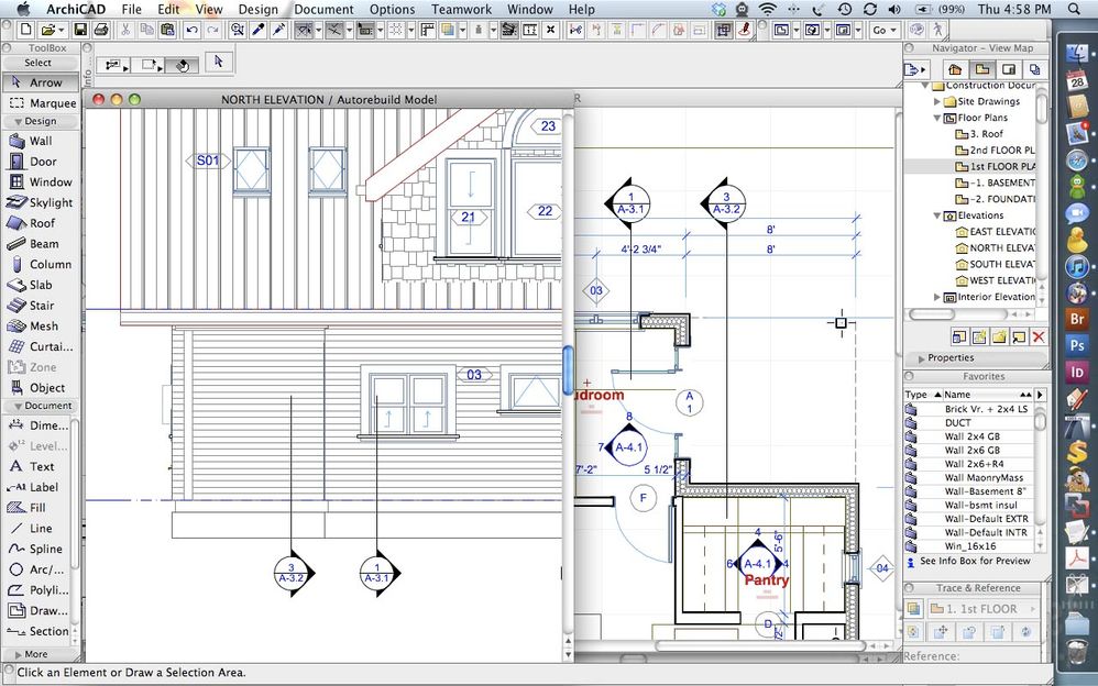

Section markers in elevations
(new AC user)
I want to show in my elevations where some of my sections are cut (see attached image). Is there a better way to do this than using a Linked Marker, manually inserted in the elevation view? It seems like only getting halfway there... it updates automatically when i rearrange drawings, but if I move the actual section cut, I have turn on a trace reference and move the Linked Marker manually.
All helpful advice is appreciated.

That's the best way AFAIK.
Not that we do that here, but if there's a better way I'd like to here it.
I presume that since S/E markers aren't 3D elements they can't show up in other views. It would probably take a fundamental change in these tools to achieve what you want, and even then it could be tricky to control.

methy wrote:
Im surprised I thought Link would have a better idea for this
But i guess it requires a software improvement.
I've got plenty of good ideas for this and a lot of other things, but sadly they're not in the program yet!
As I said earlier it would be a great feature but would be tricky to dictate which marker appeared in which viewpoint. Not impossible but it could get rather complex and confusing.
