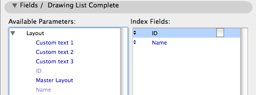

So... I have multiple sheets listed in our index which automatically generates. All of the sheets start with a letter associated to the type of work it represents.
ie. A-architectural, AS-architectural site work, C- civil, etc
my problem is that the sheet index automatically formats the index to list alphabetically. The problem is that our document sets do not read this way. How can I customize the sheet order?

I assume your letter division codes are in the layouts' IDs. In the index, you want the sort button of the ID field to be blank, as opposed to ascending or descending. This way the layouts are listed in the order of the layout book.
