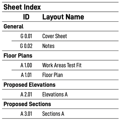

Sheet index - how to create sub headers dividing different sheets?  Please see the attached sheet index and example of what I want it to look like.  Thank you

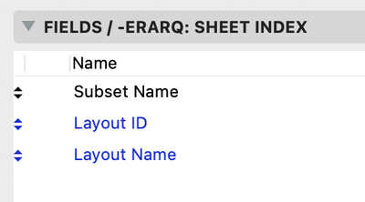

To achieve this:
You'll need to Create Subsets in your Layout Book:
Sort the Index by:
and turn on:
Take into account that in some cases it will be easier to create multiple Indexes instead of trying to get one that is perfect.

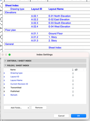

One option is to create a new property to Layout Info Scheme in Book Settings, eg. "Drawing Type":
Then you can set the drawing type in layouts' settings:
Then it's possible to display the custom layout property in the sheet index and group the items by this value:
3 REPLIES 3

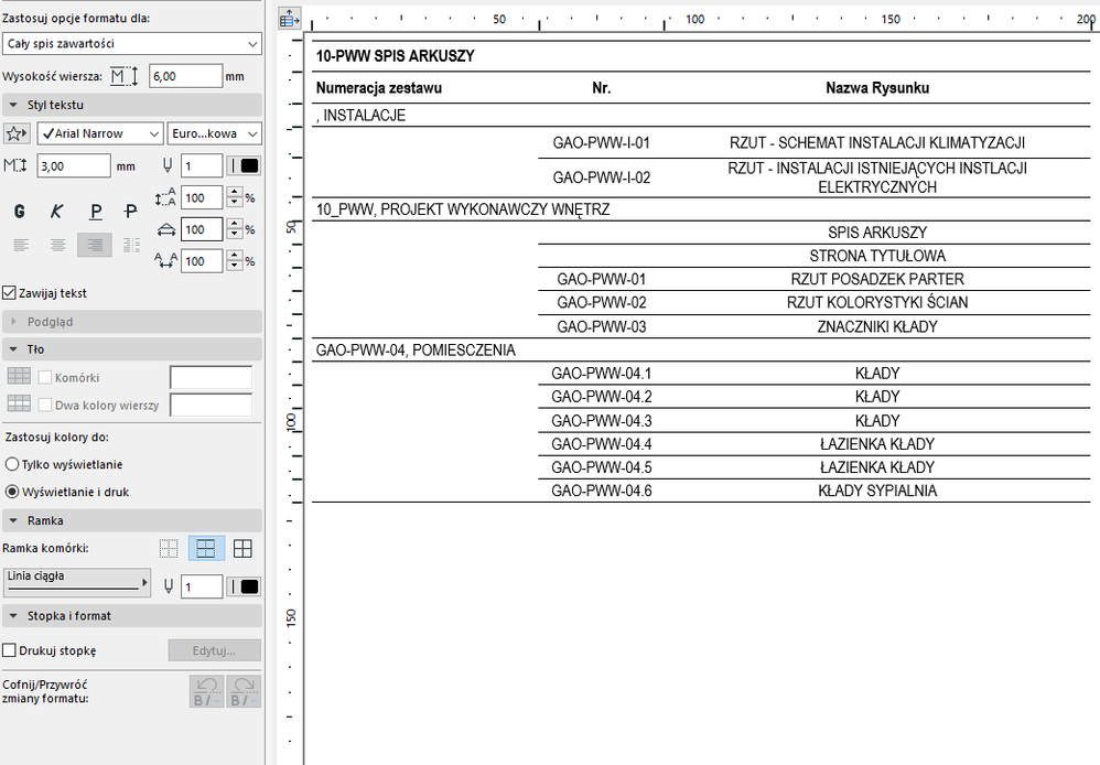

Hi !
You should place those sheets in folders in the layouts view.
I know that the screenshots are in polish, but you will get the idea.
Michał
