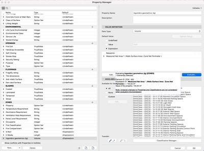

Here's the property expression
And it works technically

This is curious. I reproduced the settings from your screenshots, and indeed, the Property returns a correct value if I select a Zone and evaluate the Property in the Property Manager Dialog, but for some reason, I can not select it to be displayed as part of the Zone Stamp.
Why this is is beyond me so I will forward this to GS and we will see if they have an answer for it.
