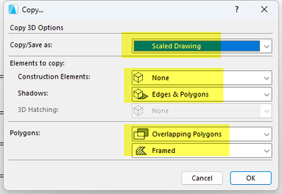

If you have your location settings correct (Project Preferences > Location Settings > longitude & latitude) and you have shadows turned on it the 3D style settings, you should now see the shadows cast in the 3D window.
Place a 2D marquee over the shadow area and press copy.
A dialogue will appear so you can choose to copy just the shadows.
Now you can go to your floor plan and paste the shadows.
I hope that is what you are after.
