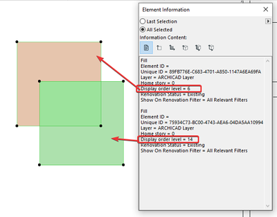

I draw a 2D fill in an interior elevation view and use display order to place it correctly. When a teammate opens the IE layout the display order is different. This is super inconvenient and I remember this problem from older versions as well...16, 17 something. It seems the display order is somewhat connected to settings on the client instead of the cloud!? I have no reminiscens of this happening with other views that IE.
Anyone else experiencing this? Workarounds? We've worked our way around this by assigning the task of creating the IE views/layouts to only one person (the person that did the 2D-fills) but in the large projects it's not a viable workaround.

In case you want to quickly check you can compare the Display order level of certain element if its the same for both users on teamwork, you may use Element information palete for that
