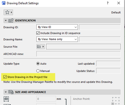

In the layouts I have only links to internal views, but it is true that in some of the internal views I also have imported drawings (pdf files that are 3MB)
2022-08-22 03:10 AM
That could be the problem.
Only way of knowing is to remove the PDFs and see if speed increases.
I don't think the option to 'Store Drawing in the Project File' will do anything, as it will still be looking to that link for an external PDF.
I think that will just make your file size bigger and means that it can still read the PDF even when the external source is not available.
