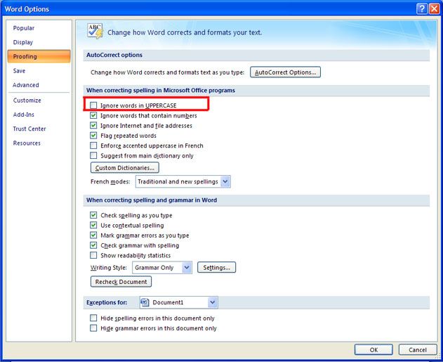

I hope somebody is still following this Topic. I am in AC 13 and tried the advice to set spell checker to system but "system" was no longer an option to add. So my question is, has anyone figured out how to make the AC 13 spell check work for words in all caps; because I'm tired of having to copy and past everything into google.
P.S To Graphisoft
It's the 13th release of an architectural drafting program, you haven't figured out that architects write notes in all caps on drawings, and provided a spell check that works. Are you honestly trying to compete, or have you given up and are just collecting our checks?
Hence, this may not be any help to you, but if you have MS Word installed correctly on your machine ArchiCAD will recognise and correct capitilised spelling errors only if you adjust the settings of the spell checker in Word.
See the attached Options screen for Word 2007. This is to be found in the big 'Office' button in the top left of the window - look underneath the recent documents list.
Also, I believe the 'system' spelling feature may be on Macs only. Your profile says PC.
Hope that helps.
THANKS PETER.
I HAD THE CAPS SPELL CHECKER OFFF.
MUST BE A DEFAULT THING:-)))
