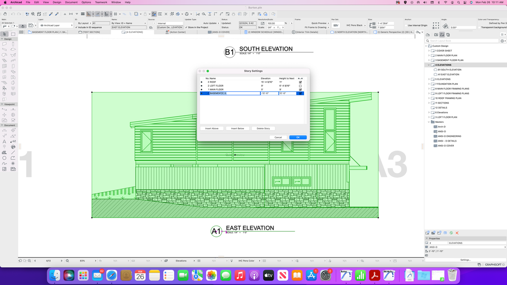

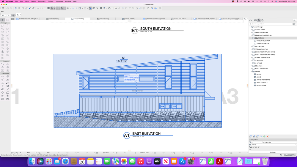

Archicad 27 on a MAAC platform - when I'm in the view map, looking at elevations, the story lines show up fine. However, when I go to the layout book, the lines disappear. How can I get them to show up on the layout book sheets?

Not on mine. The lines show up on the view map, but not on the layout book . The story lines are all turned on

Please show us screenshots from your settings.
2024-02-26 07:12 PM
2024-02-26 07:20 PM
Solution: Figured it out. Have to go into the view map, right click on the elevation/elevation settings/click on Display & output on the story levels box
2024-02-27 10:33 AM
You can access the Elevation Settings by right cicking on the Elevation Marker, Elevation on the Project Map, or on the Placed View.
