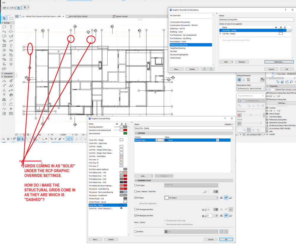

Structural grid linetype not showing up as "dashed" due to graphic override
see attached.
structural grid lines not being able to be changed to "dash"...due to graphic override. how do I change this?

In your GO rule, add a criteria for ... Element type is not Grid Element.
I think that should filter it out.
