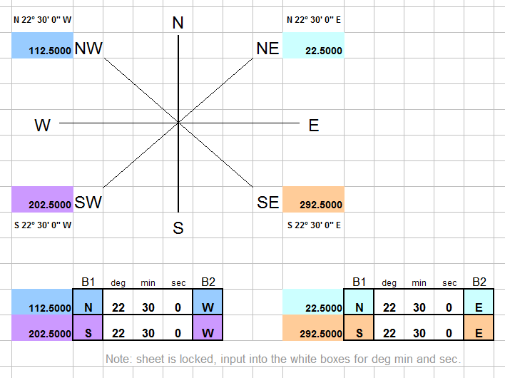

Surveyor's units do appear to be broken. You'll have to convert to angles in Working units and then change the display back to Surveyors units. I have a spreadsheet for converting the Northing etc to 360 degree values if you are interested.
