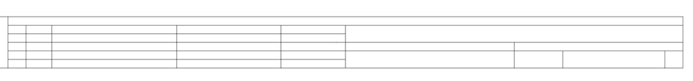

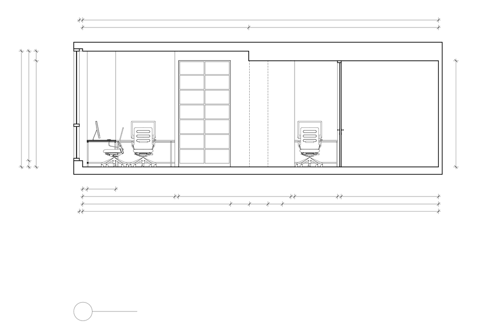

I'm having the same problem with ArchiCAD25.
Screen Shot 2022-09-23 at 10.04.23.pngScreen Shot 2022-09-23 at 10.04.33.png
Missing text style is Helvetica if it helps
