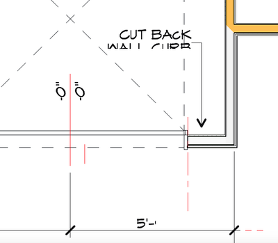

When I set the 2D Drawing Acceleration to off, zooming in and out is much slower! 

I just purchased an external monitor, hooked up to my new Macbook Pro 2021 (16") and have the same issue, with Archicad 25, Build 4013.  I can't use Archicad if it functions in this manner.  When will there be a fix?

I apologize for the delay in getting back to you. I was frustrated with the way the program was behaving on my Macbook that I went back to using my old iMac (and downloaded a copy of Archicad 25 solo) and didn’t have the issues there.
I then went back to the Macbook to try to reproduce the disappearing dimension text and it would no longer allow me to open my files (because they were now saved to a newer build of Arch25 solo). Therefore, I updated my Macbook’s software to the latest build (4014) and I no longer have the issues with the text disappearing on the dimension lines when zooming in and out on the drawings.

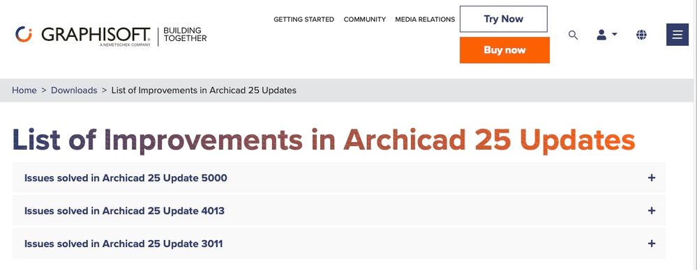

When I look for updates from Archicad self, it says it's up to date.
See attached image of options when you go directly to the Graphisoft website..
Don't see version 4014, only 5000 and it says preview version. What am I missing?
