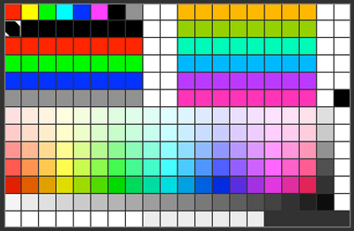

I agree that using multiple pen sets adds layer of unnecessary confusion and that changing pen colours/weights would be better controlled in one place through graphic overrides, while using just a single pen set.
See attached image of a pen set that I use - top left are drafting pens, bottom left fill colours, bottom right landscape/nature colours, and top right (pink) are blank for project specific pens.  It works great and provides all required pens.  One issue is that Archicad ships with library objects, walls, curtain walls etc. with the thousands of pen settings already setup to match their multiple pen set logic; so applying this single pen set creates a mess of incorrect line colours/weights, and every object needs manually updated to suit.
As mentioned by others, the GO 'Override Style' options are quite limited and for example we can't change 'cut' lines vs 'projected' lines or individual line settings inside of objects.  Revit uses a single pen set, with more comprehensive graphic override options, being able to choose 'cut' vs 'projected' and dig down into each line type inside of objects (ie. window sash, wall skin lines, etc.) and it is much simpler to use than using a mix of multiple pen sets/GO's.

That's similar to the one we use.
We've been using for a couple of years now and haven't had any issue.
With regards to being able to check line weights, we haven't really had a problem with that.
We toggle between true line weight on/off, if unsure then it probably doesn't matter.
