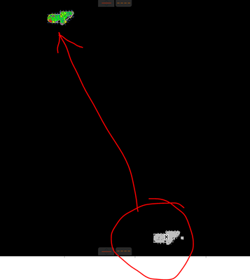

I have been using Trace & Reference for a few years and it's working just fine. There is 1 particular file that has a bug in it and I'm not sure how to fix it.
I already have several stories. I created a new story (let's call it 4th story) to paste my info into it. When I paste the plan into it, I made sure that it's paste in the Original Location.
When I turn on my Trace and Reference Tool, this new story that I created is way off the chart, I have to activate the "Move" tool in Trace and Reference to move it to where it's supposed to be. Pls help me fix this, it's only happening on this one specific file and I'm not sure why.

Turn on the trace reference and display of the storey below. Use the trace reference Reset to default position option.
Is the contents of the 4th storey supposed to be directly over the 3rd storey? If yes then display the storey below as a trace reference and drag the 4th storey information to the trace reference. Your new 4th storey information may have simply been placed in the wrong location.

My Archicad file is a combination of 2D and 3D. I pasted a 3D element on a new story, and the origin doesn't line up. Is there a way to check the origin of the main story (1st floor) and check the origin of the new story and see if I can update it to match the origin of the 1st floor?

When you paste it asks you where you like to paste did you choose original location ?
AC 27 INT 5060/WIN 11
yes, definitely, everytime. And the difference in distance is always the same like what I showed in my original post.

That "Reset to Default Position" works perfectly, thank you so much!
Not sure why that happened on the 4th storey content even though I pasted the content in the Original Position. Thanks!!
