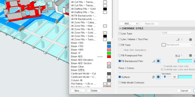

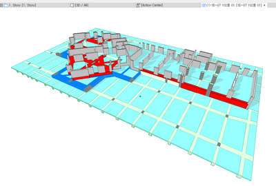

1.Transparency is applied to the slab in the 3D view, but it is not applied in the document.
Is it impossible?
2. When creating a document, add ! The mark appears, how can I erase it?

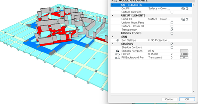

There are two ways to solve it.
1.check the surface of transparency. It must be above 80% to show transparent in 3D document.
2.check the 3D document setting make sure that the check box of transparency was ticked.

You are overriding with a transparency of 30%.
You may need a higher value as Akpocky mentioned.
Also is the 3D Document set with the correct Graphic Override?
