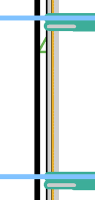

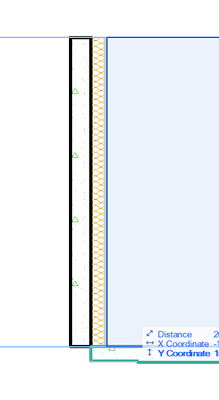

Is the display order meaningless when hotlinking?
A.
B.
I'm working on the apartment as an exercise.
But A.pln ------> B.pln
B called A through hotlink.
By adjusting the display order, the structural wall was set to 10 and the finishing wall was set to 7 to resolve the side walls. Of course, there is nothing wrong with the cross section in the A file.
However, if you import only the 5th floor of A through Hotlink and create a cross-sectional view from B copied by floor, the line of the finished wall will come in front of the structural wall.
1. Is the display order meaningless when hotlinking?
2. Because it is a side wall without an opening, the structural wall and the finishing wall were separated. ^^
In ArchiCAD, shouldn't walls be separated even where there are no openings?
3. Is the display order (1~14) a value given to one object? (If the display order is 7, then it is 7 in section and 7 in elevation... Is it 7 in all views?
