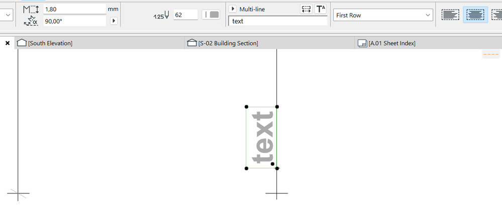

In the settings-barr , there is an option called...Measured Value....click on the little arrow beside it and choose...Multiline-text.
Now you can edit that value in whatever you want. Just click in the Input Textbox, write your text behind what is written or erase it and write your own text.
Hope that it works for you. (see attached file).
