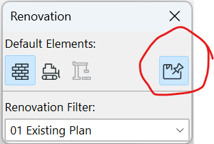

I had a similar problem today but with Polyline/Line and Library Objects. AC 27 Build4060. Not a teamwork file.
No matter what they didn't work, I was able to use them, but they didn't appear on Project/View map. I checked the classification options and both Renovation Status & Show on Renovation Filter were in grey and a day before they were okay.
For me the solution was :
Window > Palettes > Renovation Palette > Unpin whichever filter is active.
I don't have any idea what was the reason for this, but what I did could be the solution for your issue too.
