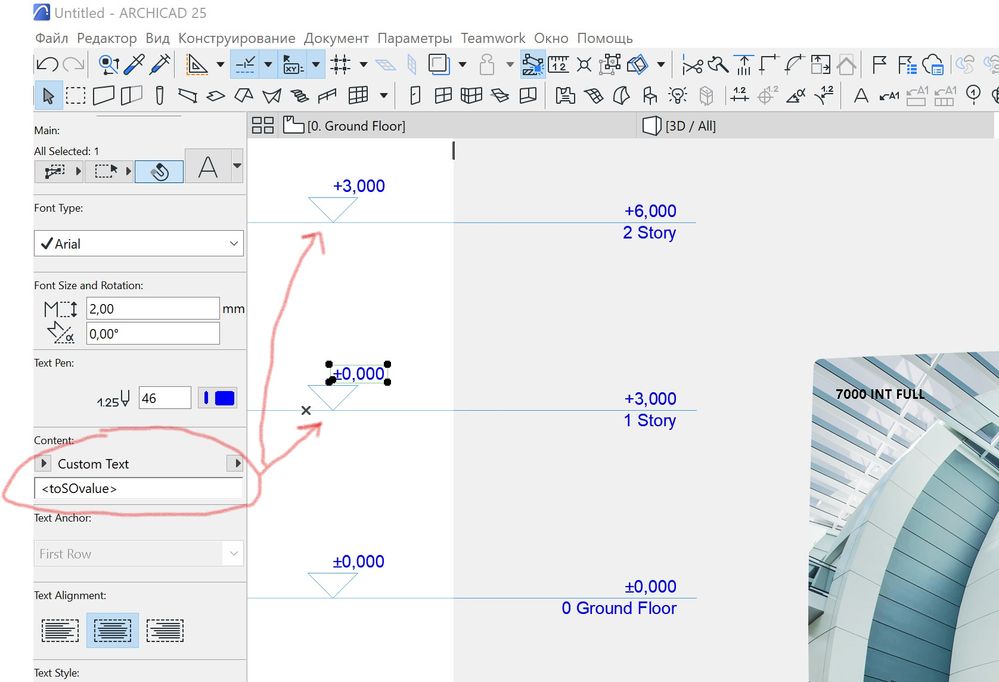

BoNgO
Update 6000 for Win!
The main problems are still unresolved!
1. Height markup with custom start flies off on layouts and shows a value from 0 project!
Problems in working in teamwork:
1. Dimensions attached to centerlines fall off from the anchor point.
2. Dimensions on reamers attached to elements fall off from the anchor point.

Installed the INT version with update 7000
The problems I wrote about above remained! And they are critical!

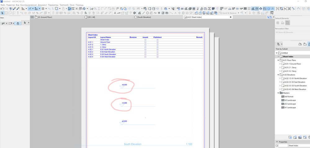

In confirmation of my words, I attach a screenshot with the problem of marks on the layout!

I am still not 100% clear on what is happening here.  Your story levels are turned on in your elevation/section (see attached).  These will always appear at the extent of your elevation/section marker.  My thought is these are the ones that are 'flying' off of the layout.  In addition, you have added some elevation dimensions, that maybe are not quite dialed in the way you would like in terms of the representation.  You may have some problems with reference elevations so you might check there to see if you can tweak it so you can get it looking the way you like.

I'm not talking about what the elevation marks look like.
Elevation mark value with "custom start" to display the value 0.000 at any mark, on the views is displayed correctly, but on the layout flies to the mark relative to the zero of the project
