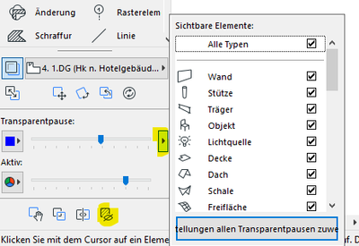

Hello,
I'm experiencing significant performance issues when using a trace reference from the View Map. However, the performance gets much better when I trace the same view directly from the Project Map.

I’d like to point out that this issue hasn’t always been a problem. I clearly remember that several years ago, tracing any View directly from the View Map was fast and smooth. Now, there are times when the mouse doesn’t move at all.
I can’t recall exactly which version of Archicad introduced this change, but it seems to have since become a persistent issue.
As a Structural Engineer, this is a major problem for me because I rely heavily on tracing architectural drawings. I believe "dwg hatches" (or fills in Archicad) are the main cause. Even when tracing from the Project Map, the hatches cause lag, and while I can hide some layers, others are essential for completing the structural model. This significantly affects my productivity and efficiency.
I truly hope Graphisoft can address this issue.

Hi Takis,
you can try turning off the hatches (but not the Hatch layers), or you can try sorting some elements out. I hope this works!

Takis
Hi Owais,
Thanks for replying.
Yes, but it is not the fills of Archicad that I'm hiding but the hatches in the imported dwg file which it is imported as an "External Reference", so I'm turning off the hatch layers directly in the imported files. The Archicad types do not affect the imported file.
