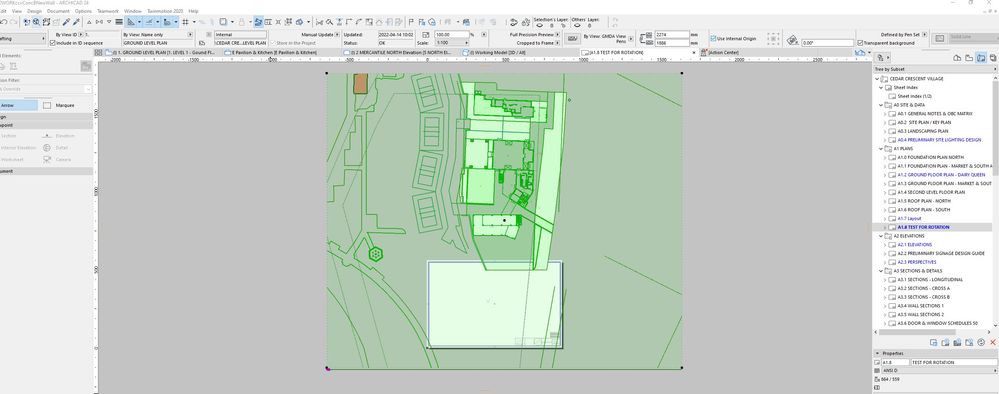

I have an orientation and zoom saved for my View Map plans.
So when I open my View Map, it opens to the correct orientation.
But when I place the views onto my Layout, the orientation is different, even though the orientation is set to 0deg.
Anybody care to point me in the direction to fix it?

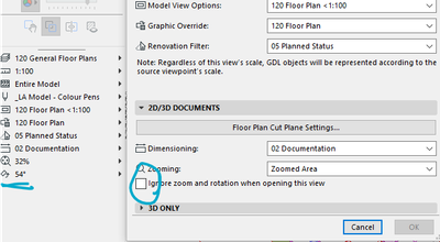

Patrick M
are the view settings in the view map set to "ignore zoom and rotation"? IMO, this should almost ALWAYS be unchecked

Patrick Hayes
As above it looks to be a view setting thing, not the drawing settings. Your view should have a rotation saved and the ignore thing should be unticked.

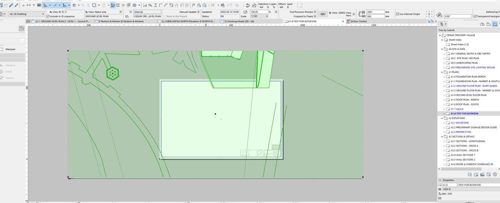

I created a new Layout to test this, and:
This is the View Map.
Then when I drop the View Map onto the Layout both the orientation and "zoom" is different. Most of the plan is cut off in the crop.
So if I stretch the crop, I can at least see the plan, but the orientation is still wrong.

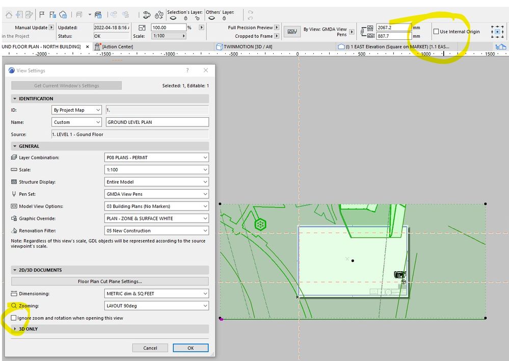

Patrick Hayes
Can you post a screenshot of the "quick options" palette when you are in your saved view - this should show the rotation of the view in the view map.
Then, can you show a screenshot of the drawing settings in the layout.
This will help diagnose what's happening.

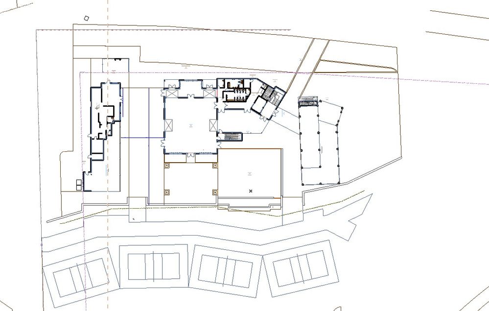

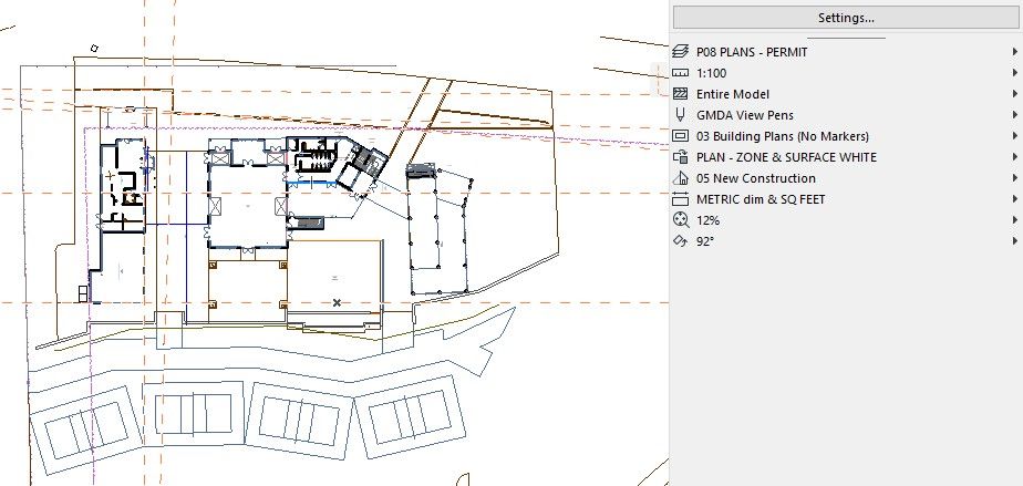

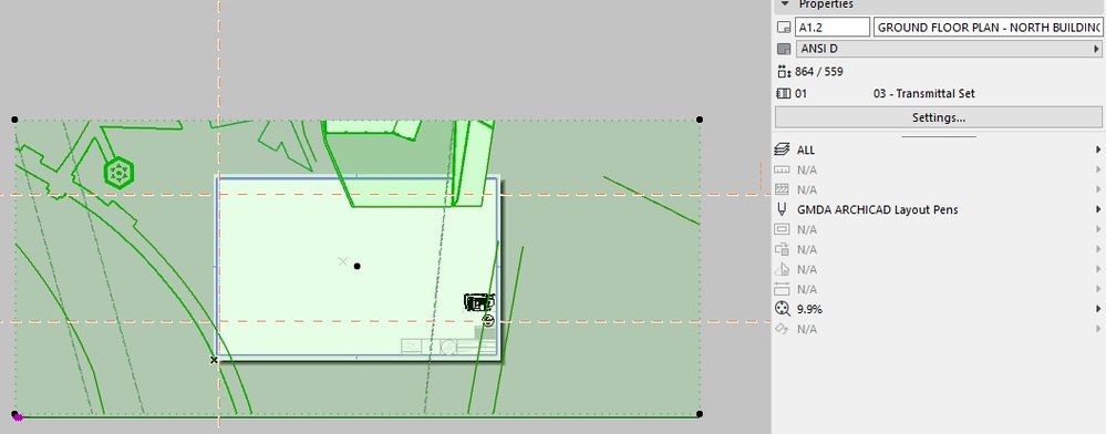

Johann_P
Hi @Patrick Hayes
Couple of screenshots.
1st) Shows the saved View Map.
- With Quick Options open.
2nd) Shows how it arrives in Layout when I drag & drop it.
- cropped with different orientation.
3rd & 4th) Shows with the settings open.
I highlighted the "Internal Origin" before I read your whole email....
ArchiCAD24 - since Nov 2020
Revit - 2005 to 2020
Windows 10 Pro
2 screens: nvidia quadro RTX 4000
Johann_P
@ryejuan
Ok, so this is embarrassing.....
I usually do the "Redefine with current window settings" every time I make a change.
Considering that the plan opened in the orientation and view I required in the View Map I guess made me believe I've already done the "Redefine with current window settings"
But after watching your videos (thanks for that) I did the "Redefine with current window settings" anyhow, and the View Map to Layout orientation and crop is now correct.
