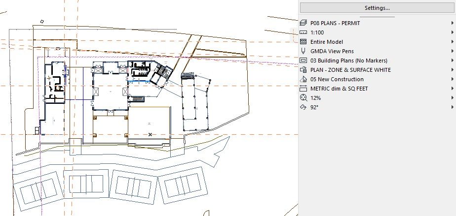

I have an orientation and zoom saved for my View Map plans.
So when I open my View Map, it opens to the correct orientation.
But when I place the views onto my Layout, the orientation is different, even though the orientation is set to 0deg.
Anybody care to point me in the direction to fix it?

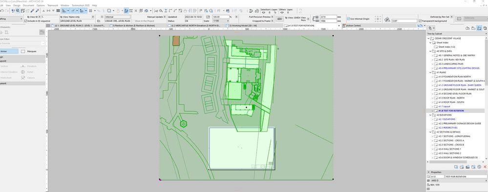

I created a new Layout to test this, and:
This is the View Map.
Then when I drop the View Map onto the Layout both the orientation and "zoom" is different. Most of the plan is cut off in the crop.
So if I stretch the crop, I can at least see the plan, but the orientation is still wrong.

Can you post a screenshot of the "quick options" palette when you are in your saved view - this should show the rotation of the view in the view map.

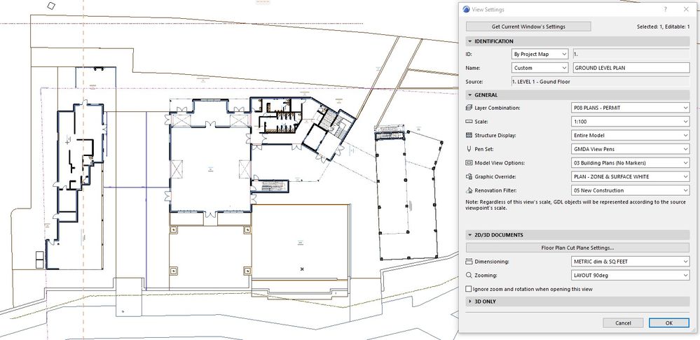

Then, can you show a screenshot of the drawing settings in the layout.

Hi @Patrick Hayes
Couple of screenshots.
1st) Shows the saved View Map.
- With Quick Options open.
2nd) Shows how it arrives in Layout when I drag & drop it.
- cropped with different orientation.
3rd & 4th) Shows with the settings open.

Ok, so this is embarrassing.....
I usually do the "Redefine with current window settings" every time I make a change.
Considering that the plan opened in the orientation and view I required in the View Map I guess made me believe I've already done the "Redefine with current window settings"
But after watching your videos (thanks for that) I did the "Redefine with current window settings" anyhow, and the View Map to Layout orientation and crop is now correct.
