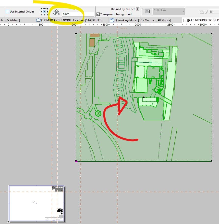

I have an orientation and zoom saved for my View Map plans.
So when I open my View Map, it opens to the correct orientation.
But when I place the views onto my Layout, the orientation is different, even though the orientation is set to 0deg.
Anybody care to point me in the direction to fix it?

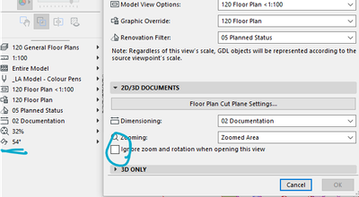

4dProof
are the view settings in the view map set to "ignore zoom and rotation"? IMO, this should almost ALWAYS be unchecked
Yeah I agree with you. It always messes up with the layout orientation when this is checked... Also trying checking your model view orientation if you saved it under the correct view map, sometimes can be overlooked. ๐Ÿ˜Ž

As above it looks to be a view setting thing, not the drawing settings. Your view should have a rotation saved and the ignore thing should be unticked.

@4dProof
Yup, the View Map "ignore" is unchecked.

I created a new Layout to test this, and:
This is the View Map.
Then when I drop the View Map onto the Layout both the orientation and "zoom" is different. Most of the plan is cut off in the crop.
โ€ƒ
So if I stretch the crop, I can at least see the plan, but the orientation is still wrong.
โ€ƒ

Can you post a screenshot of the "quick options" palette when you are in your saved view - this should show the rotation of the view in the view map.
Then, can you show a screenshot of the drawing settings in the layout.
This will help diagnose what's happening.

Couple of screenshots.
1st) Shows the saved View Map.
- With Quick Options open.
2nd) Shows how it arrives in Layout when I drag & drop it.
- cropped with different orientation.
3rd & 4th) Shows with the settings open.
I highlighted the "Internal Origin" before I read your whole email....

Johann_P
@ryejuan
Ok, so this is embarrassing.....
I usually do the "Redefine with current window settings" every time I make a change.
Considering that the plan opened in the orientation and view I required in the View Map I guess made me believe I've already done the "Redefine with current window settings"
But after watching your videos (thanks for that) I did the "Redefine with current window settings" anyhow, and the View Map to Layout orientation and crop is now correct.
