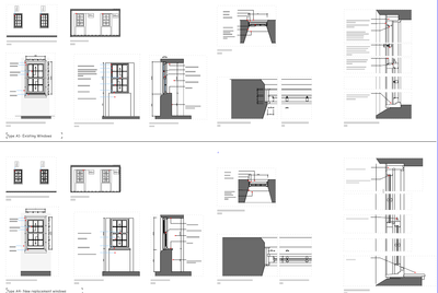

thanks this is very helpful. I have used detail call outs and then annotated using lines to get me the correct level of detail. With 15 individual traditional sash and case windows to do it seems the quickest solution and one I can control using the view. Once I get this job over the line I look at alternatives using your worksheet suggestion, but it sounds very similar to what ive ended up using. Good tip on the marquee tool.
yes I also found this a good way to develop the detail tool, but only after a huge amount of time and lots of frustration. I still not sure on how to use the custom morph tool, but I did also try modelling the window using floor tool and then saving it as a window type. Whilst this was reasonably successful, I lost a lot of the commands such as reveal type etc, so it seems a lot of work to firstly model the windows then know that id still need to adjust the detail.
thanks, I think ive also got something similar set up. Im using two detail call outs, one for existing and one for proposed. A lot of work, but then that why im charging a premium to the client for this level of detail. The exercise here is to demonstrate to the listed building officer that there is very little difference between the existing and proposed.
Thanks, but in this instance the level of detail needed would be too time consuming to model in 3d. This is a building dating back to c 1700 so we have an array of traditional sash and case window styles, each with unique mouldings, facings, stops and cases.
I have however created two instances of detail call outs to existing or proposed and that seems to work ok.
