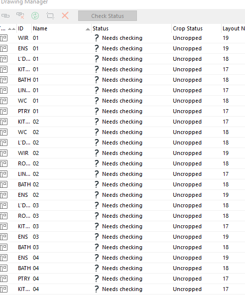

and the drawing manager for the files that keep updating shows that all drawings (needs checking)
i refreshed all and it shows that all ok but then i opened it again and it was showing the same thing (needs checking)

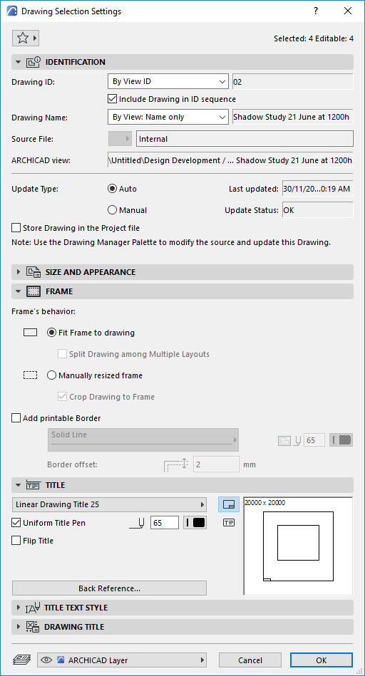

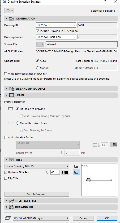

Can you show the drawing settings for one of those elevations?
I am not sure if this will offer any clues.
thanks for the help mate.
yeah i have it the same with auto and all.

Ahmad,
It seems to me, based on your Drawing Manager screenshot, that all Drawings that need updating have Interior Elevations as their source view. I wonder if that has something to do with it. Do other Drawings also have this issue, or only the ones that have Interior Elevations as their source view?
