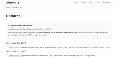

BIMDOTS came up with a solution that checks and finds all the views which have certain "custom" settings.
Check this out:
December 3rd, 2025.
  • Project Health Check can now detect Views with custom Layer Combination, Model View Option, Pen Set, or Design Option.
https://bimdots.com/product/project-health-check/
I have asked for an optimized check for "Placed Views with "custom" view settings" so I hope they will manage to solve this problem for good.
Civil Engineer, Enviromental Design MSc. BS ArchitectsVR.
Graphisoft Insider Panelist-Archicad 29. Windows 11. Intel Xeon 2699x2,64 GB RAM, Nvidia ny or personal website3080Ti. 2 Monitors.
Botonis
Mentor
Just for your info BIMDots did it.
Searching views with custom settings within the placed views!!!!!!!!!!!!!!!
https://bimdots.com/info/updates/
Great!!!!!!!!!!!!!!!!!!!!!!!!!Can't get better.
