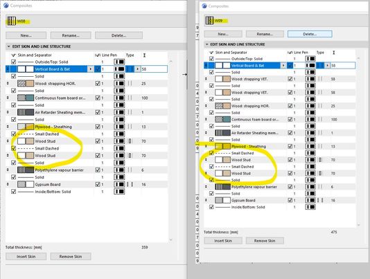

Wall Schedules sure are getting the better of me today.
So:
In my schedule is 2 walls.
I'm using 2x 70mm wood studs in both.
The one wall shows both these studs in the schedule.
The other wall only shows 1x stud, but actually does have 2 studs.
What am I doing wrong?

just a heads up -- W09 also seems to be missing the third 58mm thick Wood building material. the thicknesses don't add up to 475mm especially without the missing 70mm thick wood stud.
perhaps this is related to the missing second 70mm stud. i'd ask if you have "Merge uniform items" selected, but it clearly isn't, considering W08 shows everything correctly.
can you take a screenshot of your the schedule's Scheme Settings?

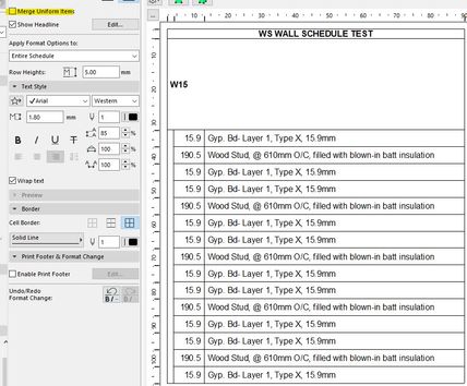

I have isolated a single wall for some tests.
I use 2 skins ie Gyp. Bd- Layer 1 and Gyp. Bd- Layer 2.
The schedule then shows what I require with "Merge Uniform Items" selected.
But when I de-select "Merge Uniform Items" I get many more layers that I'm not sure where they come from.
When I change the Skins in the composite to show 2x identical Gyp. Bd Layers, the schedule shows the following, depending on if "Merge Uniform" is selected or not.
Here is my Schedule settings:
I would say you are scheduling 5 separate walls.
When you merge they show as one because you are only showing skin thickness and name which are the same for every wall that uses that 'W15' composite.
If you can't figure out why it is showing 5 walls ...
Add 'Element ID' to your fields.
Don't merge and if they all show the same ID, edit one in the schedule so it is different.
2 other skins should change ID as well as they all belong to the same wall.
The other 4 sets should remain as they are.
Now you can use the select in 2D/2D buttons at the top to find where they are.
If you are just trying to create a wall legend of some kind, then what you have done is correct and 'merge uniform items' so you see just one for each wall composite.

Tried you recommendation, and I think the schedule is also making distinction between Home Storey, Wall height, etc, even if those fields are not selected in the schedule.
Thus, considering I have the same wall assembly across different storeys, and the same wall assembly are at different heights at different positions, I think your suggestions of selecting "Merge Uniform Items" is my best way forward.

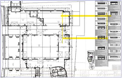

What I'm trying to accomplish is a wall schedule, that shows a little image of each wall as well as the written assembly of the particular wall, so I can tag walls on plan and a carpenter will know how to assemble each individual wall at various location on the plan.
Example below:
