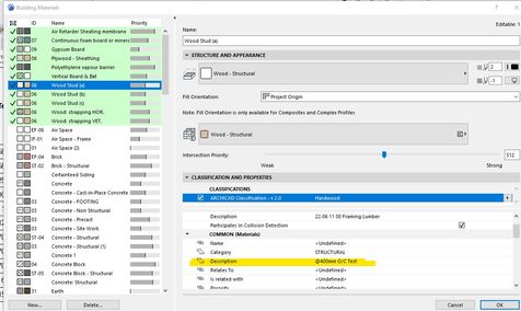

2) As for the correct Skins
It seem I have to create differently named "Building Materials" if I need the same material multiple times in a Composite.
If I just used "Wood Stud" twice, Archicad only schedules it once.
But if I used "Wood Stud (a)" and "Wood Stud (b)" it schedules both.
Is there a better way of scheduling walls which will automatically update to the changes in the composite while still giving the ability to make custom text changes?
If I was to make add this text (ie stud spacing) in the Building Material itself, I might end with a 6" & 8" & 10" Wood stud material, and duplicate those with 400mm or 600mm spacing will give me 6x "Wood Stud" Building Materials

1. Custom Text: the Custom Text field in this case is not linked to any specific element/component, it's more like for noting purpose. When you add a new skin, since the field is not linked to anything, it is not smart enough to correct itself. Thus, we see the exact same order of the Custom text, even though there is a new skin added. To have a proper link to each building material, I suggest adding a new custom property and add it to each skin, although this will limit you from having different custom text for the same building material.

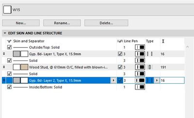

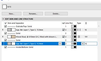

I have isolated a single wall for some tests.
I use 2 skins ie Gyp. Bd- Layer 1 and Gyp. Bd- Layer 2.
The schedule then shows what I require with "Merge Uniform Items" selected.
But when I de-select "Merge Uniform Items" I get many more layers that I'm not sure where they come from.
When I change the Skins in the composite to show 2x identical Gyp. Bd Layers, the schedule shows the following, depending on if "Merge Uniform" is selected or not.
