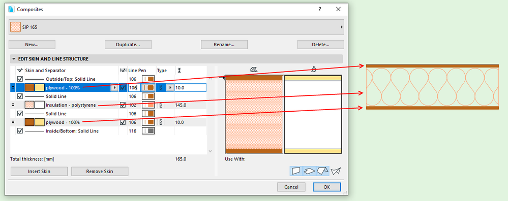

I assume you have a composite set up for that wall?
The building materials used for each skin in that composite need to have a fill with the appropriate pen colour assigned to it.
If you are wanting to use Graphic Overrides, then you can not override just a portion of the wall.
The entire element will be overridden.

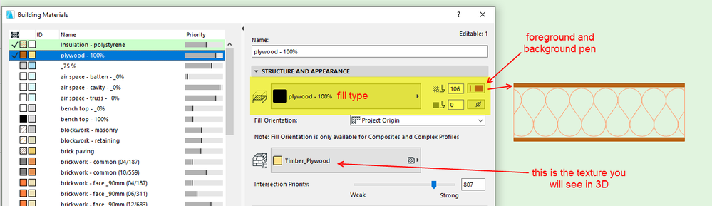

I don't have your setup, but here is something I think is similar.
Here is a composite wall and the building materials used for the skins.
Here are the settings for the building material.
The fill and pen colours you set here are what you will see for the 'cut' fill of the wall.
So long as you are displaying the wall as 'symbolic' or 'projected' (the floor plan cutting plane must cut through it in this case), you should see the fill and pen colours you have set up.
It sound like you are doing it correctly, maybe just not displaying the wall as a cut wall.
